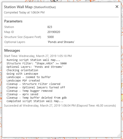

I do (though with arcpy.AddMessage).
I made a slight change as I don't like long variable names.
# Set structure area size filter.
stru = m.listLayers('Structures')[0]
fc = stru.dataSource
desc = arcpy.Describe(fc)
area = desc.areaFieldName
stru.definitionQuery = "{} >= {}".format(arcpy.AddFieldDelimiters(stru, area), sqft)
arcpy.AddMessage('Structure Filter: {}'.format(stru.definitionQuery)) ## Flow trace
Output of the script tool
I notice that the field's case changes from all caps to mixed (SHAPE.AREA vs Shape.AREA) but the results are the same.  I may also try ArcMap and Python 2.x to see what happens.  I have a couple more tweaks to do like getting the scale bars properly set, so this is not a major problem.  Hard coding will work for the time being.
