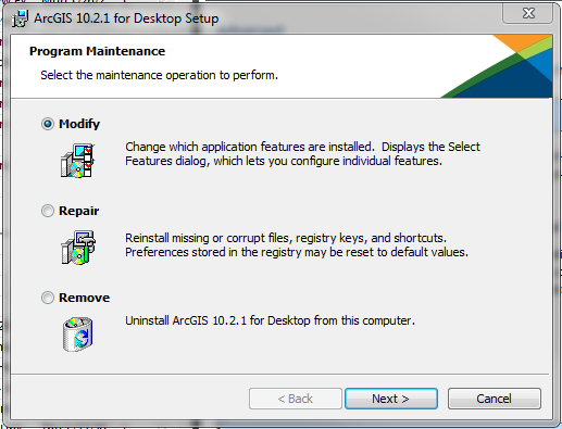

You need to find the original ArcGIS Desktop install media.
Then you can choose to Modify the current install:
And make sure Python is enabled:

So I reinstalled ArcMap and ensured python was installed but when I type import arcpy I still get an error.  I'm going to do some research of my own but in the event I don't find a solution is there anything else you would recommend?
AlexanderPugliese
Hey Ian, sorry to continually bother you, but I fixed the issue.  It was resolved using this thread: https://community.esri.com/thread/86343  My only question now for you involves what the map opens in.  Is there any way I can configure the addon to open in google earth?
