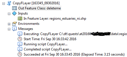

Another problem was with an output parameter. I created an output parameter of type FeatureClass and set its direction to "Output". When I run the tool, the output was produced but it is not added to the map document (Add output of geoprocessing operations to display is checked) and the result object suggests the output is a table and not a feature class. I can see the resulting feature class in catalog window OK.

Below  is preview of result and the script.
