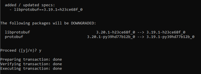

I just found a temporary fix, downgrade the following package:
conda install libprotobuf=3.19.1=h23ce68f_0
This will allow ArcPy to import successfully within a VSCode notebook. Unfortunate, but probably a good talking point about library conflicts, package management, and sometimes you have to have a workaround.

Thanks for your report of this fix. We've uploaded a new build of the ArcPy package for 3.0 which reflects this change and should work for any new environments, or after doing conda upgrade arcpy in an affected environment.
Cheers, Shaun
