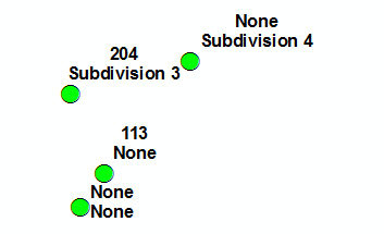

It suppresses the error. However, this will return None if there is no data:
The nice part of using the python expression is that you can enhance the result, replacing the None for a different text

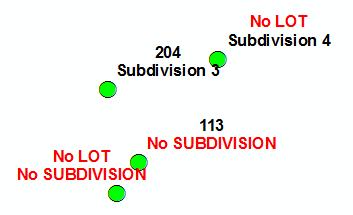

... or adding some formatting to the text:
def FindLabel([LOT] , [SUBDIVISION]):
  return "{0}\n{1}".format([LOT] if [LOT] != None else "<CLR red='255'>No LOT</CLR>",  [SUBDIVISION] if [SUBDIVISION] != None else "<CLR red='255'>No SUBDIVISION</CLR>")
will give:

... will result in:
will give:
