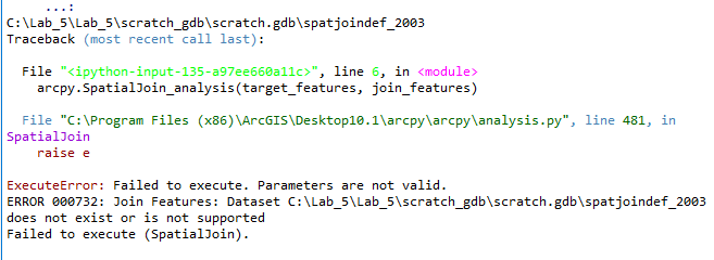

Hi,
I'm trying to do a spatial join between sevaral feature classes as join features and one feature class as the target feature. I have written a python script for this but I get an error when I execute it.
import arcpy
arcpy.CheckExtension('Spatial')
arcpy.CheckOutExtension('Spatial')
arcpy.env.workspace = 'C:\Lab_5\Lab_5\AAB_gdb\AAB.gdb'
#This is to check if these are the feature classes that I want to use
defor_years = arcpy.ListFeatureClasses("def*")
for i in defor_years:
print i
#This is to create the output name for each spatial join
output = 'C:\Lab_5\Lab_5\scratch_gdb\scratch.gdb\spatialjoin_'
for i in range(0,len(defor_years)):
   year = defor_years
   name = output + str(year)
   print name
join_features = name
#Setting the variable for the target features
target_features = 'C:\Lab_5\Lab_5\AAB_gdb\AAB.gdb\commune'
arcpy.SpatialJoin_analysis(target_features, join_features)
When I execute it, I get this.
I guess it's not taking each output of the for loop, making that the final spatial join failed. Can anybody help me with this? Thank youuu!!!!.

JoeBorgione
MVP Emeritus
You need to use the syntax highlighter to post code; no one can tell where your for loops end since the indentations are omitted.
Look at what the error is telling you. It may stem from you not properly seting your workspace.  I suggest using:
arcpy.env.workspace = r'C:\path\to\your.gdb'
Otherwis you need to escape each of the back slashes with a back slash:
arcpy.env.workspace = 'C:\\path\\to\\your.gdb'
That should just about do it....
SilvanaCastillo
Thank you for your suggestions. I already change what you said but it didn't work.
DanPatterson_Retired
MVP Emeritus
/blogs/dan_patterson/2016/08/14/script-formatting
Spatial Join—Help | ArcGIS Desktop
spatial join requires two 'layers', so if you aren't running the code in the interactive window or have *.lyr (*.lyrx) files,
it won't work.
you will have to make feature layers before you do the spatial join.
Make Feature Layer—Data Management toolbox | ArcGIS Desktop
