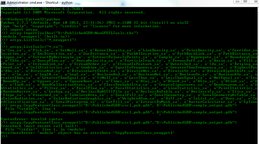

I have a python script that runs 5 Spatial ETL tools that I wish to run as a scheduled task.
Each of the tools will run successfully from ArcCatalog and also from the ArcCatalog Command line.
If I try to run the tools from the DOS window, as would be done via python script for a scheduled task, arcpy cannot find the tools, although it does load the toolbox.
In the attached screenshot: 1) I open a cmd.exe window; 2) start python; 3) import arcpy; 4) Import my toolbox, which is verified as loaded on the next line; 5) Use arcpy.ListTools to see what tools are loaded. the result is "[]", meaning no tools are recognized from this tool box; 6) I use the same ListTools to show the Spatial Analyst tools that were loaded by import arcpy; 7) I attempt to execute one of the tools from my toolbox and forget a " (my mistake!); 😎 I attempt to execute one of the tools from my toolbox and receive the message "AttributeError: 'module' object has no attribute 'CopyFeatureClass_newgpetl'".
What is preventing my tools from being recognized from the DOS CMD.EXE window while ArcCatalog and ArcCatalog Command Line can run them?

Just for anyone who comes across this same problem and searches out this discussion:
The key thing that I am missing (in this case) that causes the "AttributeError: 'module' object has no attribute..." is that I forgot to check out the Data Interoperability extension, with this:
arcpy.CheckOutExtension("DataInteroperability")
This fixed the problem on my local machine, but it did not fix the problem on our server. When I figure that out, I'll add a note about what it was to this discussion.

This is why Spatial ETL Tools are NOT being recognized on the server- in our particular case.
NIM09073:
"When calling a model with Python that contains a Data Interoperability Spatial ETL tool, the script will not run successfully from IDLE when Esri Production Mapping 10.1 is installed."
Spatial ETL Tools will not run if you have Workflow Manager (aka Esri Production Mapping) installed on the same machine. If I uninstall Workflow Manager and try the tools again, they become visible at the Windows command line.
