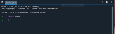

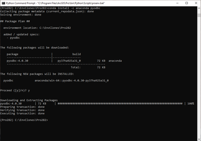

I have ArcGIS Pro 2.8.2 installed, and when I open a Python command window in my cloned env, and use conda install it installs okay and then imports okay.  It's not part of the ArcGIS Pro install apparently.
My spyder console:
Visit: https://anaconda.org/anaconda/pyodbc
That should just about do it....
