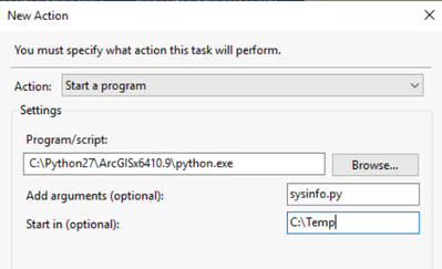

I wrote this little script and put it in C:\Temp\sysinfo.py on my Server. It will tell you the path to the python that is running, and attempt to load the arcpy module. If it succeeds it will tell you the version. If it's an old version it will still load but complain that __version__ is not there.
import sys
info = sys.executable
with open("c:/temp/sysinfo.log", "a") as fp:
    fp.write(info + '\n')
    try:
        import arcpy
        fp.write("arcpy version: %s\n"%arcpy.__version__)
    except Exception as e:
        fp.write(str(e) + '\n')
I  found my copy of Python, and set up a task using its location, like this. I set the path for Python, start up in C:\temp, and pass sysinfo.py as an argument.
I set it to run at 10:36 and then went for coffee. When I got back it had created my sysinfo.log file which contains
C:\Python27\ArcGISx6410.9\python.exe
'module' object has no attribute '__version__'
The fact that it has no attribute means it's old. On my desktop it says this,
C:\Program Files\ArcGIS\Pro\bin\Python\envs\arcgispro-py3\python.exe
arcpy version: 3.2
This script is written to run in either Python 2.7 or 3.x. If you are trying to develop code on Pro and run it in Python 2.7 on a server, good luck with that. Does Server 11 come with Python 3? I believe it does. Makes it worth switching.
