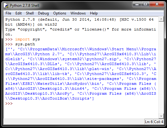

As instructed I ran the following within my Python IDLE:
import sys
sys.path

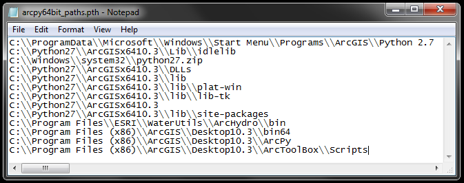

I then created the Python Path file from the list above:

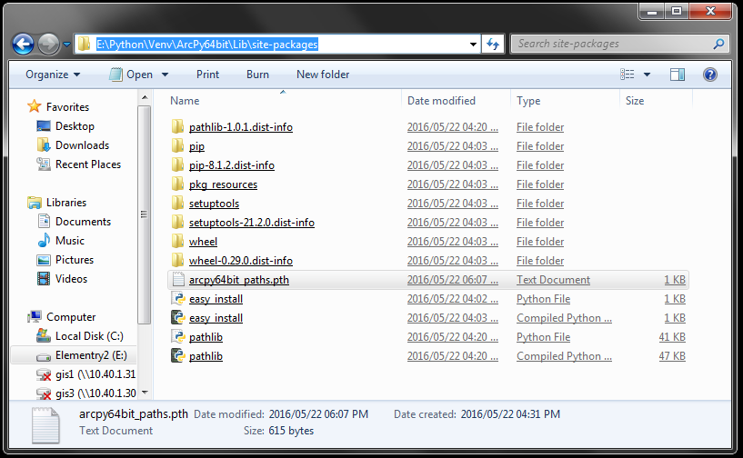

I copied the path file (arcpy64bit_paths.pth) under the following directory:
  • E:\Python\Venv\ArcPy64bit\Lib\site-packages

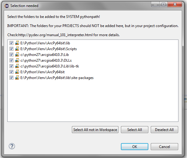

When I setup the Python Interpreter using the virtualenv within Eclipse the following paths are recognised:
ArcPy and ArcHydroTools not recognised:

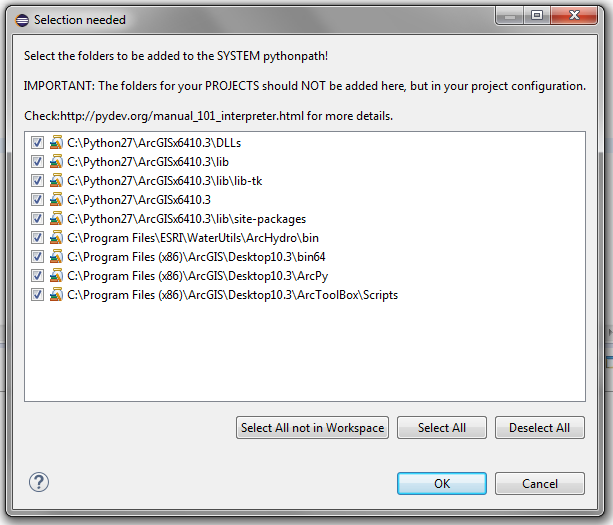

When I setup the Python Interpreter using the ArcGIS Python within Eclipse the following paths are recognised:
ArcPy and ArcHydroTools are recognised:

It's really important to make sure the order of paths in sys.path is correct. I think you may be breaking this by include everything in your .pth file. You should
1. Make sure the virtual environment is compatible with ArcGIS (esp python, numpy versions)
2. Use Esri's .pth file that they put in the \Python27\Desktop10.2x64\site-packates folder. You should only have to copy that file.
If you still are having problems, I suggest comparing the sys.path when launching Esri's 64 bit Python with what you are getting in your virtualenv. The order matters.

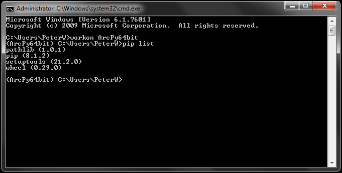

When I try to install the the specific versions of python packages required for ArcGIS:
  • Numpy (1.7.1)
  • Matplotlib (1.3.0)
  • xlrd (0.9.2)
  • xlwt (0.7.5)
  • Pyparsing (1.5.7)
based on the python requirements for ArcGIS 10.3.1
I'm unable to install Numpy (1.7.1) within my virtualenv via command line:
Python: pip install numpy==1.7.1
Python: Pip install numpy==1.7.1 error message.
If I install numpy without specifying a version it works perfectly, no error messages. I tried downloading numpy-1.7.1.win32-py2.7.exe​ but unfortunately you are unable to change the directory into which it will install. Any help to resolve the following will truly be appreciated.
