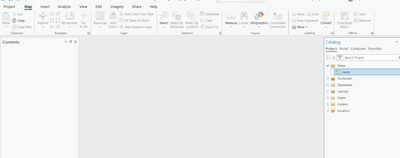

Hello everyone,
I am importing mxd projects to aprx with a python script.
I need the imported map to appear in the content panel.
Right now it only appears in the Catalog panel. My script is the following:

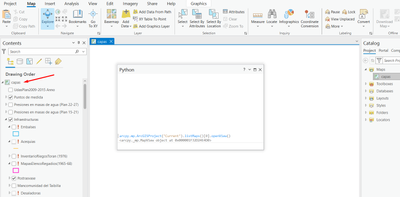

however, in the ArcGis Pro python window console it adds the map to the contents pane:
before
after run command in python window
