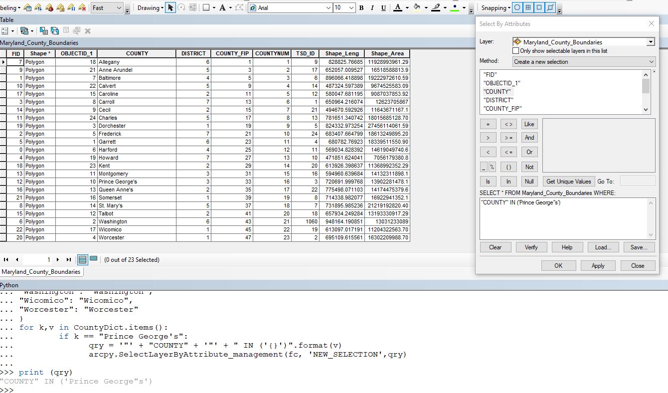

I am having trouble selecting counties that have single quotes and/or periods in their name with python that are stored in a dictionary. The below code I have works on county records with no special characters but does not with the special character counties. Any advice/suggestions?

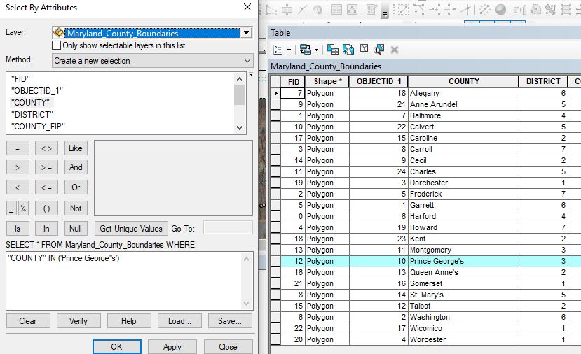

What you are seeing in the GUI isn't a double quote but two single quotes.  It isn't a Python thing, but a SQL thing, i.e., in SQL you use a double single quote to escape a single quote.

Are the county names really using double quotes, e.g., Prince George"s ?
LuisResh
The "fc" is an already existing layer and the intent was to use this bit of code in both pro and desktop within different scripts I am creating. But in desktop creating a select by attributes statement requires the double quote instead of single quote (EX: 'Prince George's' ----> 'Prince George"s').

Even after the script runs nothing happens? No error is thrown and the statement matches exactly what is used when I manually do the select by attribute tool in desktop. Below are snippets of a manual selection working but the python code not. The query from the code is also printed to show end result.
