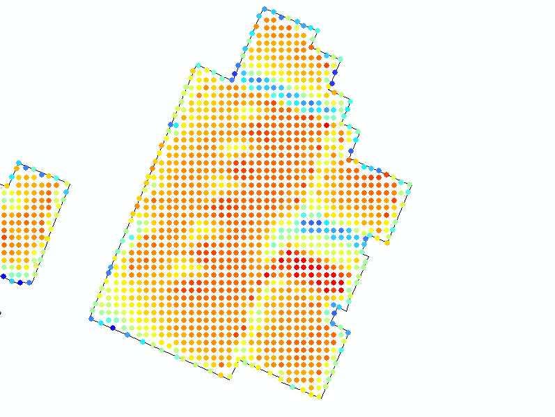

I have converted a raster into points. I have then clipped the raster with my buildings layer.
All buildings have a unique id and all the points in the same building have that id.   (ex. in the image 65379 is the unique id for that building)
What I want to do is select the top 20% of points based on an attribute value for each building. Another issue is that the number of points per building changes based on the area.
I know how many points are in each building.
I am thinking I need a for each statement but I am not sure.
Any help is greatly appreciated.
