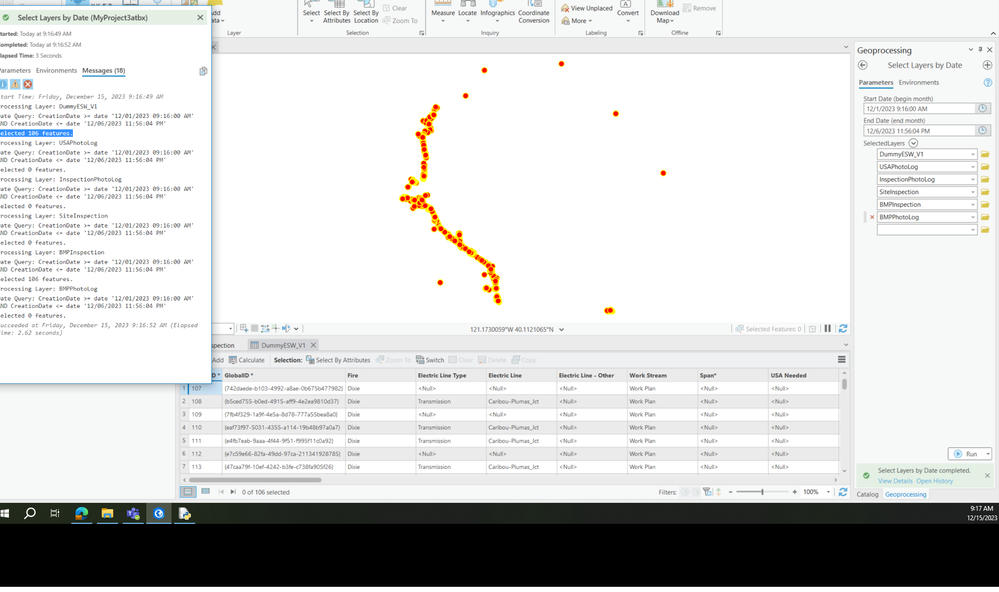

Hello All!
I am trying to build a script and that takes several layers, and selects by attribute only records in those layers within a given date range.   I am selecting from several hosted feature layers (point geometry) that are all within a single survey 123 hosted feature layer.  So there are parent records, and child+grandchild, and the date field they all share in common is called 'CreationDate' which is formatted as such: 12/6/2023 11:29:34 PM.  I am trying to run this as a script tool within ArcPro and a given .aprx.  Parameters are StartDate (Date, Input), EndDate (Date, Input), and SelectedLayers (Feature Layer, Input, Multiple Values Allowed)
When I run the script on a test copy of the data (same schema as real data I will eventually use), the script has print statements that indicate some records were selected and they are the ones I would expect.  However, that selection is not applied in the map.  When I open the table, it shows 0 records selected.  I do not understand why this is.  This is important because the next step of the script will be to use only those selected records within the give range to do a select by location process.  Any clue as to why the selection is not applied in the map but does show up in print statements as having happened (see screenshots)?   I want the next step to be: take only the selected records in the six S123 layers, and select by location all records within 50ft of those that intersect another feature class.  The Script and Screenshots are provided below.

4 Replies
