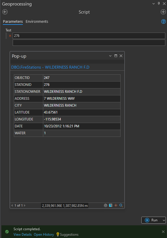

I am trying to develop a custom tool where the user can enter "STATIONID" for a fire station, and it will select it.
The fire station feature class is being stored in an Enterprise Geodatabase, and when I enter the parameter (see screenshot), it says it was successful.  However, when I open the attribute table, nothing is actually being selected.  Also, neither is the point on the map.
For future development reasons I do want the selection to be made directly from the enterprise geodatabase.  Thanks so much for the help😁.

My bet is twofold: 1) your parameter is actually text, in which case if your field is a number field, the query will run just fine but not select anything. Change the parameter type to Long (integer) if it isn't already, and/or 2) having made the parameter an integer, use GetParameter(0) instead, which will return the true value instead of a string.
alternatively, you can pop an int() around line 4, if you trust your users to input numbers.

Suspect the issue is with the .split(";") being incorporated into the qry statement.
What happens if you put a print(qry) line in between lines 7  & 8?
Didn't test with GetParameter..., but if I set the Station = '276':
>>> select_stations = "276"
>>> qry = "{0} IN ({1})".format(arcpy.AddFieldDelimiters(datasource= firestations, field = 'STATIONID'), ', '.join(select_stations))
>>> print(qry)
STATIONID IN (2, 7, 6)
Then  you can make the modifications to get the proper query statement.

Does the tool work better if you add that feature class to a map as a layer, then use the layer specifically? I've found using Select By Attribute/Location on feature class paths is flaky.
