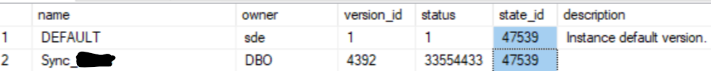

For 15 of the 16 SDEs, it's working flawlessly. The state_id values are returned to me as expected, and the Python output matches what I'm seeing within SQL Server Management Studio table view.

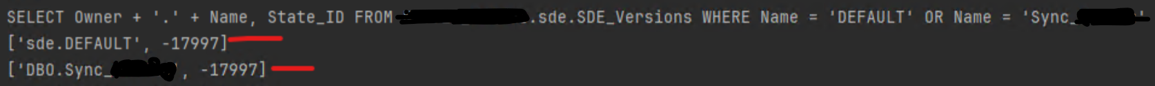

However, I have one SDE that is returning a massive negative number (in the -17,000 range).
When I saw this, I manually looked at the SQL table directly and saw that the actual state_id values were 47,539!

The interesting thing is, as the SDE's state_id values increased by 4 in the SQL table (currently 47,543), the Python output showed a decrease of 4 with the negative number (currently -17,993). So the state_id values are changing at matching numeric intervals, just within a different counting dimension somehow. Ha.

def func_sql_tables(sde_conn, sde_database_name, def_version, child_version):
    schema_owner = def_version.name.split(".")[0]
    string_SQL_Query = f"SELECT Owner + '.' + Name, State_ID FROM {sde_database_name}.{schema_owner}.SDE_Versions WHERE Owner + '.' + Name = '{def_version.name}'"
    if child_version:
        string_SQL_Query = string_SQL_Query + f" OR Owner + '.' + Name = '{child_version.name}'"
    print(string_SQL_Query)
    connect_2_SQL_Tables = arcpy.ArcSDESQLExecute(sde_conn)
    sync_Results_SQL = connect_2_SQL_Tables.execute(string_SQL_Query)
    temp_list_for_state_id = []
    for each_result in sync_Results_SQL:
        print(each_result)
        temp_list_for_state_id.append(each_result[1])
    if len(set(temp_list_for_state_id)) == 1:
        print(sde_database_name + ": All state IDs match!")
    else:
        print(sde_database_name + ": Uh oh, the state IDs don't match!")
