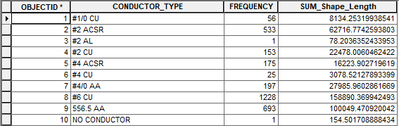

This is a huge help. I have a follow-up question to complete my script which will make my statistics workflow be much more efficient.
Here is the GDB Table that is produced:
My previous script(s) would look at each individual FC that was exported to a temp GDB and "Print" the value:

I still want to be able to print the values from getValue for each Conductor type to the Python Shell. Having a difficult time figuring out the code to print each value from the SUM_Shape_Length field while displaying the CONDUCTOR_TYPE attribute.

ModernElectric
BINGO!!
Exactly what I was looking for and the script completes at a fraction of the time compared to my previous script(s). Appreciate your assistance.
