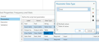

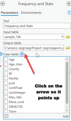

Here is on of my tools that accepts multiple values... to get a complete lists of possible selections, I just click on the little arrow beside the input parameter name (class fields in the case) and you end up with a list of checkboxes so you don't have to select one at a time.
try clicking on your arrow beside "Value"

As you can see the second picture above, I did open the drop -down list of values and checked multiple values and clicked "Add". However, it ends up with like the third picture, which is only one value is selected and I cannot add and change it.
I don't know what I am missing...

The multivalue selection returns a ";" delimited list and this is how I split it in the code
cls_flds = cls_flds.split(";")
There is no extra validation code, just what you see.  in my case "Field" was the case with multiple values desired
