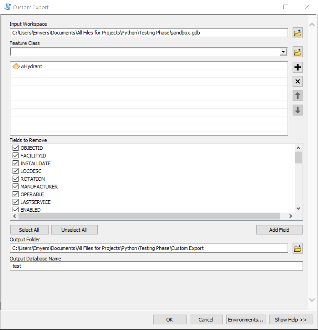

I have been trying to figure out why the Multivalue boxes in my tool don't respond with the "Select All" and "Unselect All" buttons.  They also don't stay unchecked (they are default checked) when I click other buttons.

I tried your suggestion but it caused my field pick list to be blank.  I have added a picture of my tool to better illustrate

I need to use feature layers inside arcmap for my tool to work properly.  I cannot use a file path.  There are only two issues that prevent my script from working and it comes down to the Validator.
1.  If the layers are in a group it will not work at all.  E.g. "IOError: "'New Group Layer\wControlValve'" does not exist".  On line 42, arcpy.Describe(each).fields, isn't working.
2.  If I ungroup my layers, the field list populates, but now none of the boxes will stay unchecked, making my tool useless.
Right now, the way I have my code works to an extent, it is my lack of understanding why the boxes wont stay unchecked.
