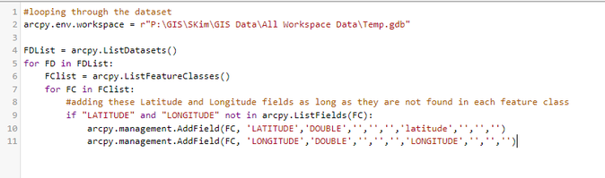

SteveKim1
Thanks Alfred for the script! When I use the second script to loop through the Datasets and then through each Feature Class, the ListFeatureClasses() function is not returning any values. Here's my script below:
Did I miss any steps or anything wrong with this code?

Oops, it looks like I should have read the documentation more closely.
What happened was that ListFeatureClasses just grabs everything from the workspace, ignoring the stuff in datasets, unless you specify that you want the stuff in the datasets.
You may also want to try out Walk(), like Joshua suggested.
arcpy.env.workspace =  r'=...\Data_Transfers.gdb'
field1 = "LATITURE" #These are mispelled
field2 ="LONGITURE"#These are mispelled
FDlist = arcpy.ListDatasets(feature_type='feature') #The parameter in here isn't strictly necessary
print(FDlist)
'''if you want to include all feature classes, regardless of wheteher they're in a dataset.'''
#FDlist = [''] + FDlist if FDlist is not None else []
for FD in FDlist:
    FClist= arcpy.ListFeatureClasses(feature_dataset = FD)
    for FC in FClist:
        print(FC)
        if not (field1 in arcpy.ListFields(FC) and (field2 in arcpy.ListFields(FC))):
            FC = arcpy.management.AddField(FC, field1, "DOUBLE",field_alias = "Lat")
            FC = arcpy.management.AddField(FC, field2, "DOUBLE",field_alias = "Long")
JoshuaBixby
MVP Esteemed Contributor
Use Walk—ArcGIS Pro | Documentation, much more Pythonic than the older List functions.  The documentation has some working examples.
