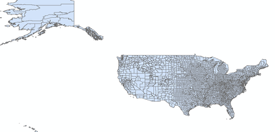

I need to make a scripts tools that will consolidate attributes from many rows into to one across a number of columns.
And the opposite of dissolve date (like drilling into data attributes) .

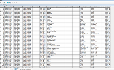

I have the  Following data attribute:
Thanks for any helps!

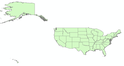

Yes, for Example i have united states and sub-states:
i want to roll up into states like this :
DanPatterson
MVP Esteemed Contributor
That is a dissolve
How Dissolve (Data Management) works—ArcGIS Pro | Documentation
You aggregate space based on an attribute or a combination of attributes.

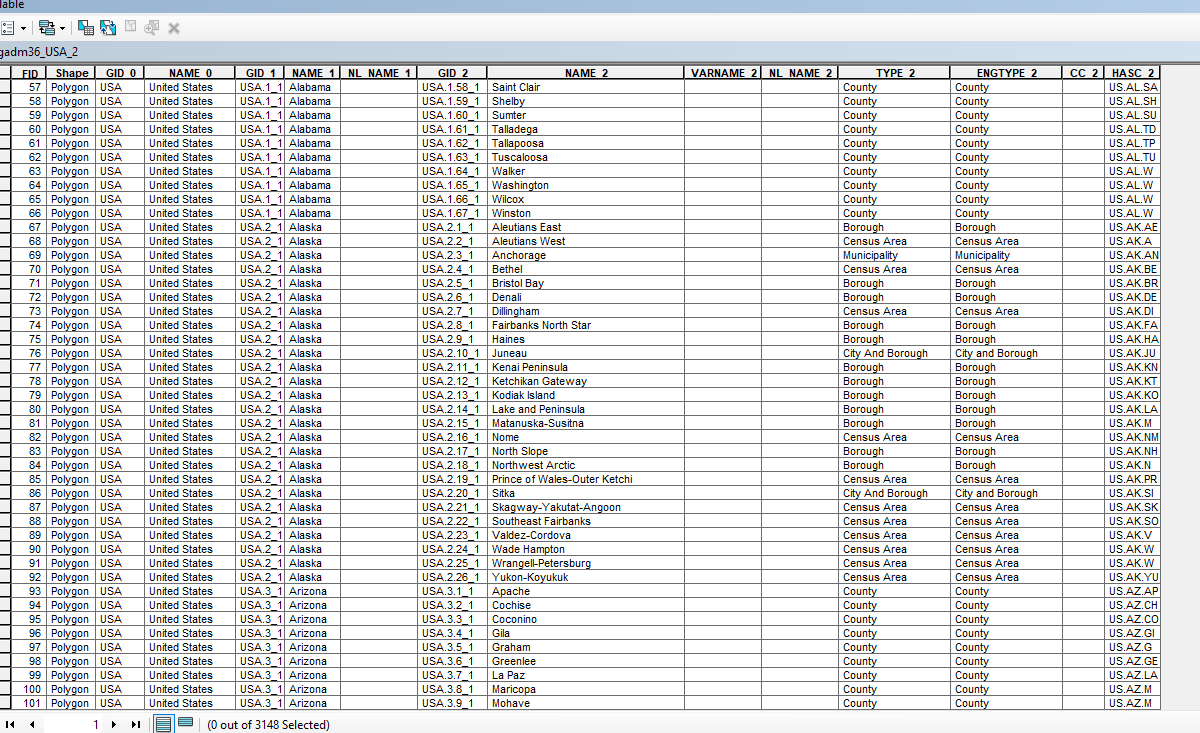

Yes thanks i know dissolve tool, and for the attributes table? did the table change?
DanPatterson
Open the table.  What parameters did you specify for dealing with the tables during the dissolve?
They are limited.
If you expect to keep the whole row's contents for each polygon that was dissolved, then you will be disappointed, because you would have to "relate" the undissolved table back to the dissolved geometry's table
