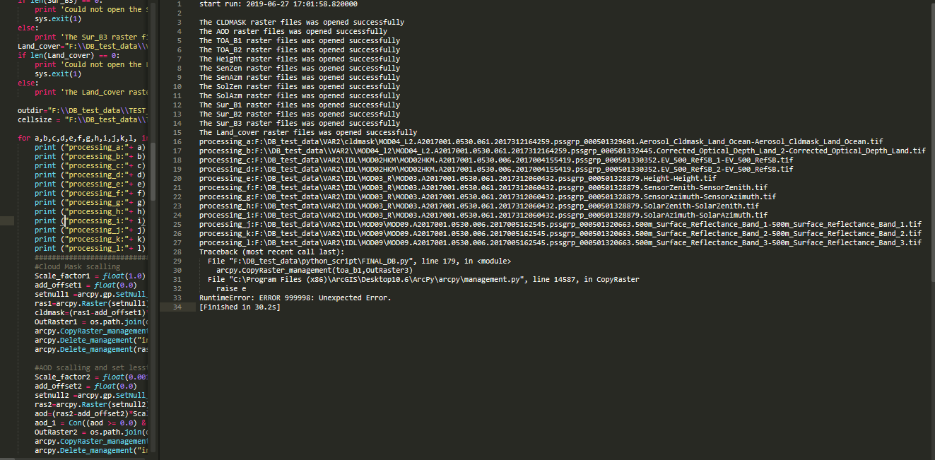

RuntimeError: ERROR 999998: Unexpected Error in Set null function
12342
35
06-19-2019 05:53 AM
BIJOYGAYEN
I am trying to write one code where I use set null function for different images and also use a simple math function for scaling the images. But when I run this code after three processes it shows
  File "F:\DB_test_data\python_script\FINAL_DB.py", line 192, in <module>
    arcpy.CopyRaster_management(toa_b2,OutRaster)
  File "C:\Program Files (x86)\ArcGIS\Desktop10.6\ArcPy\arcpy\management.py", line 14587, in CopyRaster
    raise e
RuntimeError: ERROR 999998: Unexpected Error.‍‍‍‍‍‍‍‍‍‍‍‍‍‍‍‍‍‍
here is my code

I can't understand why it shows this error.
please help me, anyone, to resolve this matter.
And have any way to use a "foor loop" for set null function of different images?

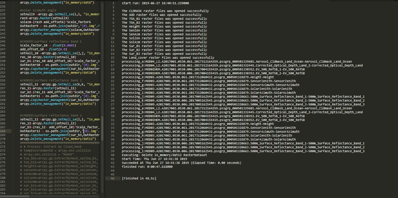

I have already uploaded the Test_data kindly check it. Also I am uploading my full code.

for a,b,c,d,e,f,g,h,i,j,k,l in zip (CLDMASK,AOD,TOA_B1,TOA_B2,Height,SenZen,SenAzm,SolZen,SolAzm,Sur_B1,Sur_B2,Sur_B3):
    print ("processing_a:"+ a)
    print ("processing_b:"+ b)
    print ("processing_c:"+ c)
    print ("processing_d:"+ d)
    print ("processing_e:"+ e)
    print ("processing_f:"+ f)
    print ("processing_g:"+ g)
    print ("processing_h:"+ h)
    print ("processing_i:"+ i)
    print ("processing_j:"+ j)
    print ("processing_k:"+ k)
    print ("processing_l:"+ l)
    #Cloud Mask scalling
    Scale_factor1 = float(1.0)
    add_offset1 = float(0.0)
    setnull1 =arcpy.gp.SetNull_sa(a,a, "in_memory/dat1", "\"Value\" <= 0")
    ras1=arcpy.Raster(setnull1)
    cldmask=(ras1-add_offset1)*Scale_factor1
    OutRaster1 = os.path.join(outdir,'MOd0.{0}.img'.format("cldmask"))
    arcpy.CopyRaster_management(cldmask,OutRaster1)
    arcpy.Delete_management("in_memory/dat1")
    arcpy.Delete_management(ras1)
    #AOD scalling and set lessthan 0.1 AOD
    Scale_factor2 = float(0.0010000000474974513)
    add_offset2 = float(0.0)
    setnull2 =arcpy.gp.SetNull_sa(b,b, "in_memory/dat2", "\"Value\" = -9999")
    ras2=arcpy.Raster(setnull2)
    aod=(ras2-add_offset2)*Scale_factor2
    aod_1 = Con((aod >= 0.0) &  (aod <= 0.1),1)
    OutRaster2 = os.path.join(outdir,'MOd0.{0}.img'.format("aod_1"))
    arcpy.CopyRaster_management(aod_1,OutRaster2)
    arcpy.Delete_management("in_memory/dat2")
    #TOA_B1 scalling
    Scale_factor3 = float(0.000053811826)
    add_offset3 = float(-0.0)
    setnull3 =arcpy.gp.SetNull_sa(c,c, "in_memory/dat3", "\"Value\" = 65535")
    ras3=arcpy.Raster(setnull3)
    toa_b1 =(ras3-(add_offset3))*Scale_factor3
    OutRaster3 = os.path.join(outdir,'MOd0.{0}.img'.format("toa_b1"))
    arcpy.CopyRaster_management(OutRaster3,toa_b1)
    arcpy.Delete_management("in_memory/dat3")
    #TOA_B2 Scalling
    Scale_factor4 = float(0.00003255546)
    add_offset4 = float(-0.0)
    setnull4 =arcpy.gp.SetNull_sa(d,d, "in_memory/dat4", "\"Value\" = 65535")
    ras4=arcpy.Raster(setnull4)
    toa_b2=(ras4-(add_offset4))*Scale_factor4
    OutRaster4 = os.path.join(outdir,'MOd0.{0}.img'.format("toa_b2"))
    arcpy.CopyRaster_management(toa_b2,OutRaster4)
    arcpy.Delete_management("in_memory/dat4")
    #Height
    setnull =arcpy.gp.SetNull_sa(e,e, "in_memory/dat5", "\"Value\" = -32767")
    ras=arcpy.Raster(setnull)
    height=ras
    OutRaster5 = os.path.join(outdir,'MOd0.{0}.img'.format("height"))
    arcpy.CopyRaster_management(height,OutRaster5)
    arcpy.Delete_management("in_memory/dat5")
    #Sensor Zenith angle
    Scale_factor6 = float(0.01)
    add_offset6 = float(0.0)
    setnull6 =arcpy.gp.SetNull_sa(f,f, "in_memory/dat6", "\"Value\" = -32767")
    ras6=arcpy.Raster(setnull6)
    senzen=(ras6-add_offset6)*Scale_factor6
    OutRaster6 = os.path.join(outdir,'MOd0.{0}.img'.format("senzen"))
    arcpy.CopyRaster_management(senzen,OutRaster6)
    arcpy.Delete_management("in_memory/dat6")
    #Sensor azimuth angle
    setnull7 =arcpy.gp.SetNull_sa(g,g, "in_memory/dat7", "\"Value\" = -32767")
    ras7=arcpy.Raster(setnull7)
    senazm=(ras7-add_offset6)*Scale_factor6
    OutRaster7 = os.path.join(outdir,'MOd0.{0}.img'.format("senazm"))
    arcpy.CopyRaster_management(senazm,OutRaster7)
    arcpy.Delete_management("in_memory/dat7")
    #solar zenithal angle
    setnull8 =arcpy.gp.SetNull_sa(h,h, "in_memory/dat8", "\"Value\" = -32767")
    ras8=arcpy.Raster(setnull8)
    solzen=(ras8-add_offset6)*Scale_factor6
    OutRaster8 = os.path.join(outdir,'MOd0.{0}.img'.format("solzen"))
    arcpy.CopyRaster_management(solzen,OutRaster8)
    arcpy.Delete_management("in_memory/dat8")
    #solar azimuth angle
    setnull9 =arcpy.gp.SetNull_sa(i,i, "in_memory/dat9", "\"Value\" = -32767")
    ras9=arcpy.Raster(setnull9)
    solazm=(ras9-add_offset6)*Scale_factor6
    OutRaster9 = os.path.join(outdir,'MOd0.{0}.img'.format("solazm"))
    arcpy.CopyRaster_management(solazm,OutRaster9)
    arcpy.Delete_management("in_memory/dat9")
    #(MODO9)surface reflectance band 1
    Scale_factor_10 = float(0.0001)
    add_offset_10 = float(0.0)
    setnull_10 =arcpy.gp.SetNull_sa(j,j, "in_memory/dat10", "\"Value\" = -28672")
    ras_10=arcpy.Raster(setnull_10)
    sur_b1=(ras_10-add_offset_10)*Scale_factor_10
    OutRaster10 = os.path.join(outdir,'MOd0.{0}.img'.format("sur_b1"))
    arcpy.CopyRaster_management(sur_b1,OutRaster10)
    arcpy.Delete_management("in_memory/dat10")
    #(MODO9)surface reflectance band 2
    setnull_11 =arcpy.gp.SetNull_sa(k,k, "in_memory/dat11", "\"Value\" = -28672")
    ras_11=arcpy.Raster(setnull_11)
    sur_b2=(ras_11-add_offset_10)*Scale_factor_10
    OutRaster11 = os.path.join(outdir,'MOd0.{0}.img'.format("sur_b2"))
    arcpy.CopyRaster_management(sur_b2,OutRaster11)
    arcpy.Delete_management("in_memory/dat11")
    #(MODO9)surface reflectance band 3
    setnull_12 =arcpy.gp.SetNull_sa(l,l, "in_memory/dat12", "\"Value\" = -28672")
    ras_12=arcpy.Raster(setnull_12)
    sur_b3=(ras_12- add_offset_10)*Scale_factor_10
    OutRaster12 = os.path.join(outdir,'MOd0.{0}.img'.format("sur_b3"))
    arcpy.CopyRaster_management(sur_b3,OutRaster12)
    arcpy.Delete_management("in_memory/dat12")
    # # Process: Extract by Cloud_Mask
    # tempEnvironment0 = arcpy.env.cellSize
    # arcpy.env.cellSize = "MAXOF"
    # toa_bb1=arcpy.gp.ExtractByMask_sa(toa_b1, cldmask)
    # toa_b22=arcpy.gp.ExtractByMask_sa(toa_b2, cldmask)
    # heightt=arcpy.gp.ExtractByMask_sa(height, cldmask)
    # senzenn=arcpy.gp.ExtractByMask_sa(senzen, cldmask)
    # senazmm=arcpy.gp.ExtractByMask_sa(senazm, cldmask)
    # solzenn=arcpy.gp.ExtractByMask_sa(solzen, cldmask)
    # solazmm=arcpy.gp.ExtractByMask_sa(solazm, cldmask)
    # sur_b11=arcpy.gp.ExtractByMask_sa(sur_b1, cldmask)
    # sur_b22=arcpy.gp.ExtractByMask_sa(sur_b2, cldmask)
    # sur_b33=arcpy.gp.ExtractByMask_sa(sur_b3, cldmask)
    # arcpy.env.cellSize = tempEnvironment0
    # # Process: Extract by Mask using AOD less than 0.1 value
    # arcpy.env.cellSize = cellsize
    # toa_b1=arcpy.gp.ExtractByMask_sa(toa_bb1, aod_1)
    # toa_b2=arcpy.gp.ExtractByMask_sa(toa_bb2, aod_1)
    # height=arcpy.gp.ExtractByMask_sa(heightt, aod_1)
    # senzen=arcpy.gp.ExtractByMask_sa(senzenn, aod_1)
    # senazm=arcpy.gp.ExtractByMask_sa(senazmm, aod_1)
    # solzen=arcpy.gp.ExtractByMask_sa(solzenn, aod_1)
    # solazm=arcpy.gp.ExtractByMask_sa(solazmm, aod_1)
    # sur_b1=arcpy.gp.ExtractByMask_sa(sur_b11, aod_1)
    # sur_b2=arcpy.gp.ExtractByMask_sa(sur_b22, aod_1)
    # sur_b3=arcpy.gp.ExtractByMask_sa(sur_b33, aod_1)
    #Calculate the scattering angle from Resample MOD03 products
      #Css = Cos(S2 * !pi / 180.D) IDL
      #Css = np.cos(S2 * np.pi / 180) Python
    # CosSenZ = np.Cos(senzen * np.pi / 180)
    # CosSolZ = np.Cos(solzen * np.pi / 180)
    # SinSenZ = np.Sin(senzen * np.pi / 180)
    # SinSolZ = np.Sin(solzen * np.pi / 180)
    # RelAzm = np.abs((senazm ) - (solazm))
    # index = np.where(RelAzm > 180.0)
    # RelAzm[index] = 360.0- RelAzm[index]
    # index = np.where(RelAzm <= 180.0)
    # RelAzm[index] = 180.0- RelAzm[index]
    # CosRe = np.Cos(np.radians(RelAzm))
    # SctAgl =  np.acos((-CosSolZ * CosSenZ) + ((SinSolZ * SinSenZ) * CosRelA))
    # #Ray_correction for TOA_BAND_1 and TOA_BAND_2
    # #TOA_BAND_1
    # B1_ROD = (0.00864 + (0.0000065)) * (0.67)**(-(3.916 + (0.074 * 0.67)+ (0.05/0.67)))#for RED band, please change 0.67 for other bands wavelength
    # Pr1 =  (3./16.*np.pi) * (1 + (np.cos(SctAgl) * np.cos(SctAgl)))
    # wr1 = 1.0
    # RayRef_B1 = (wr1 * B1_ROD * Pr1 ) / (4.0 * (CosSolZ * CosSenZ))
    # RCR_B1 = toa_b1 - RayRef_B1
    # #TOA_BAND_2
    # B2_ROD = (0.00864 + (0.0000065)) * (0.86)**(-(3.916 + (0.074 * 0.86)+ (0.05/0.86)))#for Near Infrared (NIR) band, please change 0.86 for other bands wavelength
    # Pr2 =  (3./16.*np.pi) * (1 + (np.cos(SctAgl) * np.cos(SctAgl)))
    # wr2 = 1.0
    # RayRef_B2 = (wr2 * B2_ROD * Pr2 ) / (4.0 * (CosSolZ * CosSenZ))
    # RCR_B2 = toa_b2 - RayRef_B2
    #Calculating NDVI float raster
    # ndvi_raster = Divide(Float(Raster(toa_b2) - Raster(toa_b1)), Float(Raster(toa_b2) + Raster(toa_b1)))
    # ndvi = (Float(toa_b2) - toa_b1) / (Float(toa_b2) + toa_b1)
print arcpy.GetMessages()
print 'finished run: %s\n\n' % (datetime.datetime.now() - start)

BIJOYGAYEN
For miss TOA_B1 and a TOA_B2 raster files, we have to write these two lines:
TOA_B1 = glob.glob (d3 + os.sep + "* EV_500_RefSB_1-EV_500_RefSB.tif")
TOA_B2 = glob.glob (d3 + os.sep + "* EV_500_RefSB_2-EV_500_RefSB.tif")
I wrote that, there is no problem with it.
When I check my "test data" (Subset Data,indiviual file size 5-10kb), the code works well but it does not work on row data sets (whole India,indiviual file size 54mb) then it gives me this error: ph.I have attached the data processing screen short, please check it.I've added some files in "test_data" for your test.
Please check this problem.
There have no option to reduce and modification of this code?
Xander Bakker
Test_Data processing:working well
Row_Data processing:Error is coming

d4="F:\\DB_test_data\\VAR2\\TEST_DATA\\Clip"
Height = glob.glob(d4 + os.sep + "*.Height-Height.tif")
Height.sort()
if len(Height) == 0:
    print 'Could not open the  Height raster files'
    sys.exit(1)
else:
    print 'The Height raster files was opened successfully'
SenZen = glob.glob(d4 + os.sep + "*.SensorZenith-SensorZenith.tif")
SenZen.sort()
if len(SenZen) == 0:
    print 'Could not open the SenZen raster files'
    sys.exit(1)
else:
    print 'The SenZen raster files was opened successfully'
SenAzm = glob.glob(d4 + os.sep + "*.SensorAzimuth-SensorAzimuth.tif")
SenAzm.sort()
if len(SenAzm) == 0:
    print 'Could not open the  SenAzm raster files'
    sys.exit(1)
else:
    print 'The SenAzm raster files was opened successfully'
SolZen = glob.glob(d4 + os.sep + "*.SolarZenith-SolarZenith.tif")
SolZen.sort()
if len(SolZen) == 0:
    print 'Could not open the SolZen raster files'
    sys.exit(1)
else:
    print 'The SolZen raster files was opened successfully'
SolAzm = glob.glob(d4 + os.sep + "*.SolarAzimuth-SolarAzimuth.tif")
SolAzm.sort()
if len(SolAzm) == 0:
    print 'Could not open the SolAzm raster files'
    sys.exit(1)
else:
    print 'The SolAzm raster files was opened successfully'
#Call MOD09 images from directory
d5="F:\\DB_test_data\\VAR2\\TEST_DATA\\Clip"
Sur_B1 = glob.glob(d5 + os.sep + "*.500m_Surface_Reflectance_Band_1-500m_Surface_Reflectance_Band_1.tif")
Sur_B1.sort()
if len(Sur_B1) == 0:
    print 'Could not open the Sur_B1  raster files'
    sys.exit(1)
else:
    print 'The Sur_B1 raster files was opened successfully'
Sur_B2 = glob.glob(d5 + os.sep + "*.500m_Surface_Reflectance_Band_2-500m_Surface_Reflectance_Band_2.tif")
Sur_B2.sort()
if len(Sur_B2) == 0:
    print 'Could not open the Sur_B2  raster files'
    sys.exit(1)
else:
    print 'The Sur_B2 raster files was opened successfully'
Sur_B3 = glob.glob(d5 + os.sep + "*.500m_Surface_Reflectance_Band_3-500m_Surface_Reflectance_Band_3.tif")
Sur_B3.sort()
if len(Sur_B3) == 0:
    print 'Could not open the Sur_B3  raster files'
    sys.exit(1)
else:
    print 'The Sur_B3 raster files was opened successfully'
Land_cover="F:\\DB_test_data\\VAR2\\TEST_DATA\\Clip\\LAND_COVER_TYPE_1_Grid_2D.img"
if len(Land_cover) == 0:
    print 'Could not open the Land_cover raster files'
    sys.exit(1)
else:
    print 'The Land_cover raster files was opened successfully'
outdir="F:\\DB_test_data\\TEST_RAY\\TEST1\\c\\d\\"
cellsize = "F:\\DB_test_data\\VAR2\\TEST_DATA\\Clip\\MOD02HKM_A2017001_0530_NDVI_AA.img"
for a,b,c,d,e,f,g,h,i,j,k,l, in zip (CLDMASK,AOD,TOA_B1,TOA_B2,Height,SenZen,SenAzm,SolZen,SolAzm,Sur_B1,Sur_B2,Sur_B3):
    AA=a.split("\\")[5][0:114]
    print ("processing_a:"+ AA)
    BB=b.split("\\")[9][0:120]
    print ("processing_b:"+ BB)
    CC=c.split("\\")[5][0:88]
    print ("processing_c:"+ CC)
    DD=d.split("\\")[5][0:88]
    print ("processing_d:"+ DD)
    EE=e.split("\\")[5][0:71]
    print ("processing_e:"+ EE)
    FF=f.split("\\")[5][0:83]
    print ("processing_f:"+ FF)
    GG=g.split("\\")[5][0:85]
    print ("processing_g:"+ GG)
    HH=h.split("\\")[5][0:81]
    print ("processing_h:"+ HH)
    II=i.split("\\")[5][0:83]
    print ("processing_i:"+ II)
    JJ=j.split("\\")[5][0:121]
    print ("processing_j:"+ JJ)
    KK=k.split("\\")[5][0:121]
    print ("processing_k:"+ KK)
    LL=l.split("\\")[5][0:121]
    print ("processing_l:"+ LL)
    # #Cloud Mask scalling
    OutRaster1 = os.path.join(outdir,'{0}.img'.format(AA))
    OutRaster2 = os.path.join(outdir,'{0}.img'.format(BB))
    #TOA_B1 scalling
    OutRaster3 = os.path.join(outdir,'{0}.img'.format(CC))
    arcpy.CopyRaster_management(toa_b1,OutRaster3)
    #TOA_B2 Scalling
    OutRaster4 = os.path.join(outdir,'{0}.img'.format(DD))
    #Height
    height=ras
    OutRaster5 = os.path.join(outdir,'{0}.img'.format(EE))
    OutRaster6 = os.path.join(outdir,'{0}.img'.format(FF))
    OutRaster7 = os.path.join(outdir,'{0}.img'.format(GG))
    OutRaster8 = os.path.join(outdir,'{0}.img'.format(HH))
    OutRaster9 = os.path.join(outdir,'{0}.img'.format(II))
    OutRaster10 = os.path.join(outdir,'{0}.img'.format(JJ))
    OutRaster11 = os.path.join(outdir,'{0}.img'.format(KK))
    OutRaster12 = os.path.join(outdir,'{0}.img'.format(LL))
print 'finished run: %s\n\n' % (datetime.datetime.now() - start)‍‍‍‍‍‍‍‍‍‍‍‍‍‍‍‍‍‍‍‍‍‍‍‍‍‍‍‍‍‍‍‍‍‍‍‍‍‍‍‍‍‍‍‍‍‍‍‍‍‍‍‍‍‍‍‍‍‍‍‍‍‍‍‍‍‍‍‍‍‍‍‍‍‍‍‍‍‍‍‍‍‍‍‍‍‍‍‍‍‍‍‍‍‍‍‍‍‍‍‍‍‍‍‍‍‍‍‍‍‍‍‍‍‍‍‍‍‍‍‍‍‍‍‍‍‍‍‍‍‍‍‍‍‍‍‍‍‍‍‍‍‍‍‍‍‍‍‍‍‍‍‍‍‍‍‍‍‍‍‍‍‍‍‍‍‍‍‍‍‍‍‍‍‍‍‍‍‍‍‍‍‍‍‍‍‍‍‍‍‍‍‍‍‍‍‍‍‍‍‍‍‍‍‍‍‍‍‍‍‍‍‍‍‍‍‍‍‍‍‍‍‍‍‍‍‍‍‍‍‍‍‍‍‍‍‍‍‍‍‍‍‍‍‍‍‍‍‍‍‍‍‍‍‍‍‍‍‍‍‍‍‍‍‍‍‍‍‍‍‍‍‍‍‍‍‍‍‍‍‍‍‍‍‍‍‍‍‍‍‍‍‍‍‍‍‍‍‍‍‍‍‍‍‍‍‍‍‍‍‍‍‍‍‍‍‍‍‍‍‍‍‍‍‍‍‍‍‍‍‍‍‍‍‍‍‍‍‍‍‍‍‍‍‍‍‍‍‍‍‍‍‍‍‍‍‍‍‍‍‍‍‍‍‍‍‍‍‍‍‍‍‍‍‍‍‍‍‍‍‍‍‍‍‍‍‍‍‍‍‍‍‍‍‍‍‍‍‍‍‍‍‍‍‍‍‍‍‍‍‍‍‍‍‍‍‍‍‍‍‍‍‍‍‍‍‍‍‍‍‍‍‍‍‍‍‍‍‍‍‍‍‍‍‍‍‍‍‍‍‍‍‍‍‍‍‍‍‍‍‍‍‍‍‍‍‍‍‍‍‍‍‍‍‍‍‍‍‍‍‍‍‍‍‍‍‍‍‍‍‍‍‍‍‍‍‍‍‍‍‍‍‍‍‍‍‍‍‍‍‍‍‍‍‍‍‍‍‍‍‍‍‍‍‍‍‍‍‍‍‍‍‍‍‍‍‍‍‍‍‍‍‍‍‍‍‍‍‍‍‍‍‍‍‍‍‍‍‍‍‍‍‍‍‍‍‍‍‍‍‍‍‍‍‍‍‍‍‍‍‍‍‍‍‍‍‍‍‍‍‍‍‍‍‍‍‍‍‍‍‍‍‍‍‍‍‍‍‍‍‍‍‍‍‍‍‍‍‍‍‍‍‍‍‍‍‍‍‍‍‍‍‍‍‍‍‍‍‍‍‍‍‍‍‍‍‍‍‍‍‍‍‍‍‍‍‍‍‍‍‍‍‍‍‍‍‍‍‍‍‍‍‍‍‍‍‍‍‍‍‍‍‍‍‍‍‍‍‍‍‍‍‍‍‍‍‍‍‍‍‍‍‍‍‍‍‍‍‍‍‍‍‍‍‍‍‍‍‍‍‍‍‍‍‍‍‍‍‍‍‍‍‍‍‍‍‍‍‍‍‍‍‍‍‍‍‍‍‍‍‍‍‍‍‍‍‍‍‍‍‍‍‍‍‍‍‍‍‍‍‍‍‍‍‍‍‍‍‍‍‍‍‍‍‍‍‍‍‍‍‍‍‍‍‍‍‍‍‍‍‍‍‍‍‍‍‍‍‍‍‍‍‍‍‍‍‍‍‍
XanderBakker
Esri Esteemed Contributor
Hi HANIMANI1 ,
If the only difference between the test data and row data is the size, you should consider not writing to the IN_MEMORY workspace. I will download your data and see if it works for me too.
BIJOYGAYEN
How can I write this code without using in-memory workspace in this context? One more thing, here I write a function(set-null and some algebra function) for individual files and I write this function multiple time for multiples files(code line 162-270). can I use this function in a single for loop for Individual file?
Xander Bakker
XanderBakker
Hi BIJOY GAYEN
I guess you are running this in the Python window of ArcMap or Pro, since you did not check out the Spatial Analyst license. I made some modifications and it runs for me too. Since you mentioned it only does not run when using the large dataset, I recommend you to do as I mentioned and not write to the IN_MEMORY workspace.
BIJOYGAYEN
    arcpy.Delete_management(ras1)‍‍‍‍‍‍‍‍‍‍‍‍‍‍‍‍‍‍‍‍
In this function how to avoid the in_memory workspace? can you write any example code regarding this code?
Xander Bakker
XanderBakker
Hi HANIMANI1 ,
You could do something like this:
    ws = os.path.join(outdir, "name of a tmp fgdb.gdb") # this fgdb should exist
    setnull1 =arcpy.gp.SetNull_sa(a,a, os.path.join(ws, "dat01"), "\"Value\" <= 0")
    # arcpy.Delete_management(os.path.join(ws, "dat01")) # switched off so you can check intermediate results
BIJOYGAYEN
Thank you Xander Bakker, sir, for your suggestion. Yes is the need to avoid "In-memory" function when we analysis Big size data.I wrote the code a bit differently to remove the "in-memory" function, and it worked for me.
    whereClause = "VALUE <= 0"
    # Execute SetNull
    outSetNull = SetNull(a, a, whereClause)
    cldmask=(outSetNull-add_offset1)*Scale_factor1
    OutRaster = os.path.join(outdir,'MOD04_L22.{0}.tif'.format("CLDMASK"))
    cldmask.save(OutRaster)
I have another problem regarding the trigonometric calculation in raster data. I am trying to write simple trigonometric calculation(code line 295-330) using numpy but it gave me one error.
  File "F:\DB_test_data\python_script\FINAL_DB.py", line 295, in <module>
AttributeError: 'module' object has no attribute 'Cos'

How do I resolve this matter or have any other way to write this code in the arcpy environment?

Hi HANIMANI1 ,
I'm glad it worked replacing the in_memory workspace by a real workspace. Indeed if size starts te become big, in_memory is not a good option.
Regarding the other question, you should use "np.cos" all in lower case.
