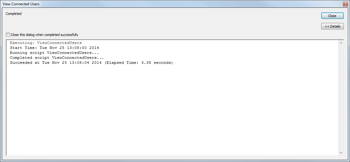

I have a python script that I have just written and I am able to run it quite simply by opening the CMD window, and typing >>>python myScript.py and it runs great, it shows me all my print commands as it runs through.
Now I have it working I want to add it to my Toolbox so I can simply run the script once a week to do what I have set it to do.
I have quite simply right clicked the toolbox, and selected ADD | Script... I then get it to point at my myScript.py file, and thats it.
So then I go back to the script in my catalog, and double click it and it runs. But unfortunately I am unable to see any of the Print statements as its the esri window, it only lets me know when its complete.
Basically see the first screenshot of the text the script prints out, this is what I like...
2014-11-25_12-58-31_CWindowssystem32cmd.exe - python  Importing_CAD_Data.py.jpg
See this second screen shot, this is the ESRI version, I am hoping to get all my print statements to show in this window... is it at all possible??
Thanks heaps for your time.

Just to give you a better idea of my problem, the below script returns a list of Users currently connected to my SDE... this script is only useful if i run it from the CMD window, if I run it from Catalog as a script it displays the window shown in my first post.. and as you can see it does not return a list of connected users.
Cheers

Hi Owen, thanks very much for that, has worked well for this little script.
So are you saying that print statements are not recognised by this ESRI window at all? I need to use AddMessage and AddWarning instead from now on?
Thanks again.
curtvprice
MVP Alum
That's correct. Script tool messages can only appear in geoprocessing results if you use the arcpy methods to send those messages. On the plus side, these messages are not only printed, they are saved as results in the Results window for later review.
