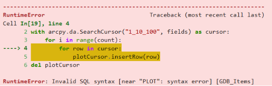

I am trying to use an InsertCursor/SeachCursor to transfer data from one dataset to another wile incorporating a repeating tuple. The first dataset (in the below code is "Forest_Surface_Fuels") contains all the data and has attribute fields for each record that contains data for 1hr, 10hr, and 100hr fuels. What I am trying to do as I transfer this data to a empty dataset ("1_10_100") is to not only take the values in those fields, but create a master list for all records in a project and in a new field state whether the data is a 1hr, 10hr, or 100hr.

When I run this, I get this error:
Thanks!

KevinDickinson1
I keep getting an error, but want to confirm something first, when you define src_fields, where you have 'Plot_' that should be the corresponding field in "Forest_Surface_Fuels" to 'Plot_' in the out_fields, correct? I replaced 'Plot_' in those instances with 'Macroplot' and still get this error:
