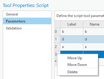

Assuming you are using a custom toolbox (*.tbx), right click your script in the toolbox and select "Properties", select the parameters tab and then right click on the parameter you want to move and select "Move up" or "Move down". And then change the parameter references in your code.

Thanks for the response.
Unfortunately, that is exactly what I am trying to avoid; moving the parameters manually like that means I have to change every other reference. So #10-->3, #3-->4, #4-->5, etc.
