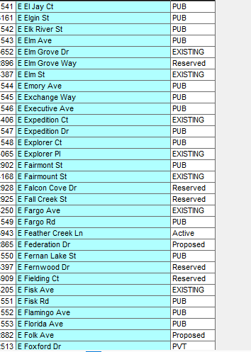

CCWeedcontrol
I need to remove just the pre-directionals and keep the name.
Thanks.
E El Jay Ct --> El Jay Ct
E Elgin St --> Elgin St
E Elk River St --> Elk River St
