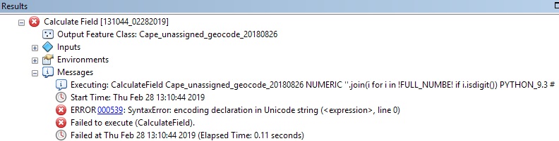

Mike, or anyone, are you still out there? Your solution worked perfectly for me in a field calculation a couple days ago. Now, using the same fields in the same database, but a different selection of records, I'm getting an error. I'm too much of a dolt in Python to see why. Here's what I'm getting:
"syntaxerror: encoding declaration in unicode string (<expression>, line 0)" (see below)
At first I thought it might be some characters that were causing the issue (hyphens, slashes, spaces), but eliminating them didn't help.
Any ideas?
