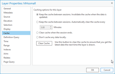

With my cache setting as follows:
I can not reproduce.  Pro always updates the table when the calculate field script finishes.  Doesn't  matter if I pick the TOC layer from the dropdown or navigate to the FGDB FC directly.

I was not aware of this propery but even select the do not cache did not solved the problem.
