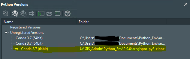

Hi @JamesCrandall
I use PyScripter for ArcGIS Pro. When you open PyScripter there is the Python symbol (blue and yellow), click that and select Setup Python Versions.
A window will appear, the second icon in is for adding an environment, click it and select the folder that contain the environment you wish to use. (folder that contains python.exe)
For example, I make a clone of the environment using ArcGIS Pro and place it on a shared drive. (You can point directly to the install version). From here, anyone that uses PyScripter can access the same environment that I am using. Once you have added the folder path to the window you can highlight it and press the run button, the first icon in the screenshot above, or double click the entry.
You will see the interpreter window update and you are good to go.

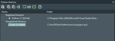

ShaunWalbridge
You can still use PyScripter, but note that you'll need the x64 version since Pro and Enterprise 11 are both 64-bit only. To configure it, you'll need to tell PyScripter where your installation is, by selecting Run > Python Versions > Setup Python Versions. From that dialog, you'll want to navigate to the arcgispro-py3 folder, if you're using the default environment. For Pro, that might look like:
If you're doing this on the Server, you can similarly configure it to point at the Pro runtime included in Server, see https://enterprise.arcgis.com/en/server/latest/develop/windows/scripting-service-publishing-with-arc... for the paths.
There are many other IDEs also available like VSCode, but if you're comfortable with PyScripter it should work fine.
Cheers, Shaun
