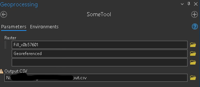

JohannesLindner
MVP Alum
Hmm, the way I see it, there are at least 2 options.
Option 1: Don't use batching, use multivalue parameters.
class SomeTool:
    label = "SomeTool"
    def getParameterInfo(self):
        return [
            arcpy.Parameter(name="raster", displayName="Raster", datatype="DERasterDataset", parameterType="Required", direction="Input", multiValue=True),
            arcpy.Parameter(name="csv", displayName="Output CSV", datatype="DEFile", parameterType="Required", direction="Output"),
    def execute(self, parameters, messages):
        par = {p.name: p for p in parameters}
        rasters = str(par["raster"].value).split(";")
        with open(str(par["csv"].value), "w") as csv_file:
            csv_file.write("Header line\n")
            for raster in rasters:
                # extract and write for each raster
                csv_file.write(str(raster) + "\n")
Option 2, if you really want to batch: Check if the output csv exists. If not, create it and write the header line. Then use append mode to write the extracted raster values.
Have a great day!
Johannes
Manu
Thanks, I didn't know about the multiValue option. This is exactly what I needed!
