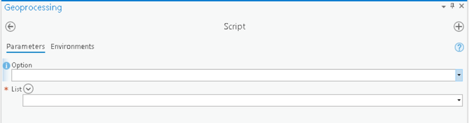

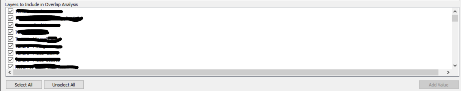

I am migrating the tool into ArcGIS Pro/Python 3 using the same validator script and as I noted in a previous post that the behavior of multi value parameters have changed slightly. In the Desktop environment, the list would populate in the parameter along with check boxes next to each item so the user can toggle the items that want the tool to run on:

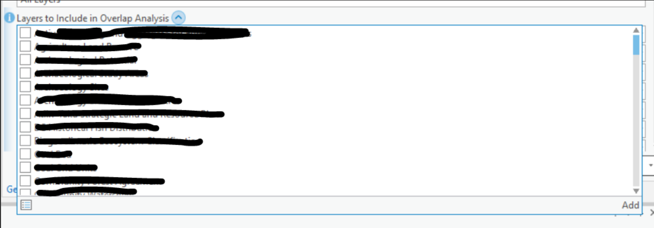

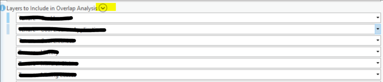

In the Pro environment the parameter will populate the list, but in order for the user to choose the items from the list they want, there is a drop down button above the parameter that pops out the same list in a new menu where they have the option to toggle on or off the items (see highlighted button below). The second image shows the popout list.
Now the issue is, the original list will populate in the order that I have set in the validator, however the popout list will only populate in alphabetical order. This is onerous for my users because the list I actually use is quite large and we want to have some of the more important items in the list at the top for ease of access and to prevent the users from scrolling through the list for these items when they are set in alphabetical order.

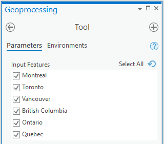

Mike, can you provide a bit more of your script? I can't reproduce (using Pro 2.6.1).  With the following script (not using a validator, but just setting the parameters) I get your desired behaviour:
class Tool(object):
    def __init__(self):
        """Define the tool (tool name is the name of the class)."""
        self.label = "Tool"
        self.description = ""
        self.canRunInBackground = False
    def getParameterInfo(self):
        """Define parameter definitions"""
        param0 = arcpy.Parameter(
            displayName="Input Features",
            name="in_features",
            datatype="GPString",
            parameterType="Required",
            direction="Input",
            multiValue=True)
        param0.filter.type = "ValueList"
        valueList = ['Montreal', 'Toronto', 'Vancouver', 'British Columbia', 'Ontario', 'Quebec']
        param0.filter.list = valueList
        param0.values = param0.filter.list
        return [param0]

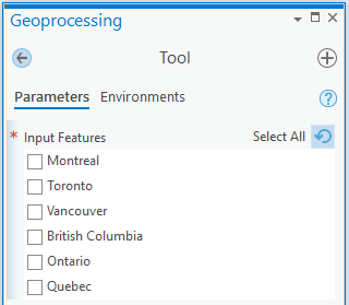

If I don't set /comment out param0.values = param0.filter.list then I get a very similar result , just without anything selected:

Thanks Luke. So, as mentioned above, the issue doesn't occur in the list that gets populated when the tool opens, it's when you click on the dropdown (highlighted in the image I posted above) and then a 'sub list' pops out. It's in the sub list where the order of the list is re-sorted alphabetically.

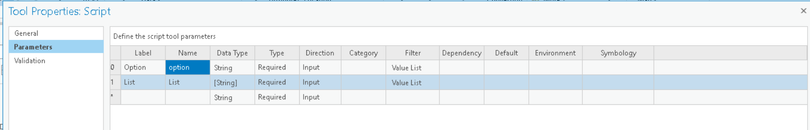

To start with, I simplified the tool a little to focus on this issue. Here is a screen grab of the parameters and their properties:
Where the properties are as follows:
Param[0] (This is a Value List that contains some options. When the user chooses one of the options, than the second parameter updates its list using some logic to re-organize the list based off of that option. This isn't the focus here, but worth noting)
  • String
  • Required
  • Input
  • Value List (populated with 'Test1', 'Test2', 'Test3')
Param[1]: This is the list that I am having issues with the ordering.
  • String (Multi Values)
  • Required
  • Input
  • Value List
My validator script is here:

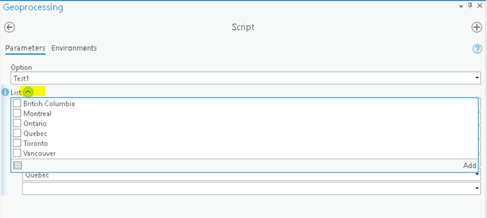

Ok, so that all set up in a standalone tool in a toolbox, when you open the tool, it should look like this:
Now, choose an option (in this case, Test1) and it should look like this:
and here is the rub. When you click on the drop down arrow next to 'List' in the image above, the popout list (so that the user can check off the items they want) it re-orders alphabetically on it's own:
