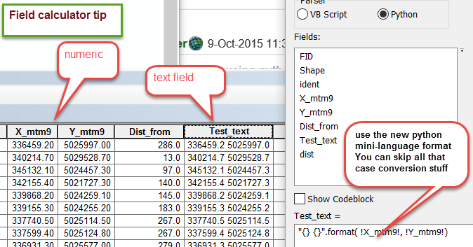

DanPatterson_Retired
MVP Emeritus
Or try this tip

curtvprice
MVP Alum
I'm trying to join 2 fields.  the corridor field and the RM field. Calculate Field (PYTHON) str(!CORRIDOR!) + str(!RM!) worked but it adds a .0 to the end of the RM..  I created the RM field as a short with 0 decimal places.  So it returned C000001E156.0.  The precision is set to 4
Try this Calculate Field syntax
arcpy.CalculateField_management(tbl, field,
    "{}{:.0f}".format(!CORRIDOR!, !RM!), "", "PYTHON_9.3")
