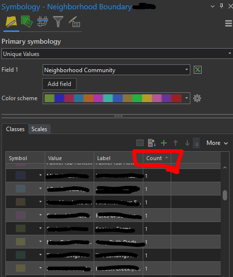

Does anyone know if Esri has exposed the Count values within Python's ArcPy for the unique value renderer items? The current documentation indicates that the Item's description, label, symbol, and values are exposed via Python. However, ArcGIS Pro allows you to also display the number of occurrences per item by toggling the Count field (i.e. Show Count) within the Symbology pane:
Unfortunately, I am unable to find this option within Python thus far.

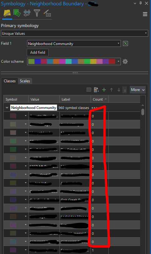

For our workflow, we do not "refresh" our unique value symbology each time a change is made. Pre-existing symbology needs to remain static. Because of that, we opt to add missing values (with .listMissingValues()). Afterwards, we manually go into ArcGIS Pro and check/remove any out-dated unique values that show a Count of 0:
I'd like to automate this process where the script removes any unique values with a Count of 0, but that doesn't appear to be possible based on the documentation I've found thus far. I may be looking in the wrong place though.

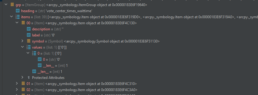

I was thinking it would have a list of the values that fit that value, but it just drills down to just the single value of the values:
Here is an example of the recursive remove:
