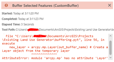

Hello,
Can somebody advise me on how to code this properly? The below script was attempted using google AI snippets to create an in memory buffer layer of 500 feet based on the feature currently selected in the map. It throws an error when trying to run it. Also, if there is any advice on creating an editable layer from all features that intersect the buffer. Eventually, I plan to publish everything as a GP service.

mp.Layer is a class that you can't initialize. It's a representation of a program object. You can use it to type hint a return value, but if you want to create a layer, you need to use MakeFeatureLayer and assign the result to a variable.

and what would the error be?

BrandonPrice1
My apologies. Below is the error message. I tried changing in_memory to memory and got this same error.
