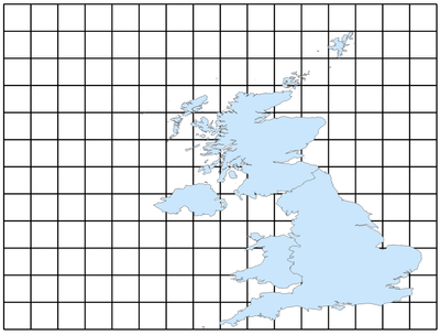

Hi there. I am fairly new to Python and I am struggling to get my first Python Toolbox to work.
The purpose of the tool is to create a fishnet over a set area, before selecting cells within the fishnet that intersect a boundary shapefile. Cells that do not intersect the boundary are deleted. See this example below which uses the UK:
The boundary shapefile has been set up to be a selectable parameter inside the tool. My current script looks like this:
