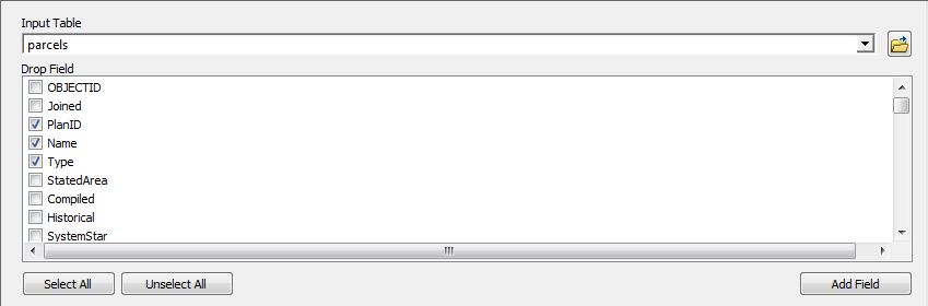

Could someone show me how to make something like this in a python toolbox as well as explain to me what is going on here?
I know that the user can select either a table or a feature class and this dialog box will create a list of the fields with check boxes. One question I have is when the user checks the fields and clicks OK, does it make a list of the checked fields or does it do something else?
The code below is a close as I've gotten to the above image, even though I know  all it does it let you select a single field from the list of fields. Any help would be much appreciated. Thanks!
