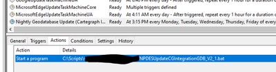

 When I run the script from the command line using a .bat file:
"C:\Users\?????\AppData\Local\ESRI\conda\envs\arcgispro-py3-clone1\python.exe" "C:\Scripts\ProjectName\ScriptName.py"

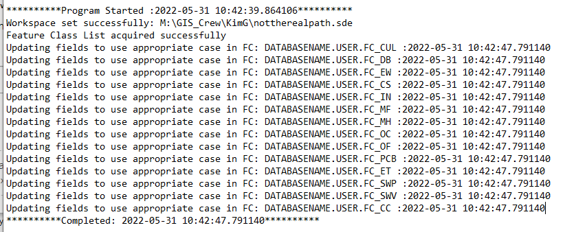

I get what I want... The below image shows the log file I write in the above code:
When I run it in the Task Scheduler I get information telling me that the list returned from the arcyp.ListFeatureClasses command is empty:

KimberlyGarbade
I cracked the case... I'm nothing if not persistent.  After writing try/except conditions and examining the description of my workspace (established using a connection file) I determined that Arcpy was indeed loading correctly and that the problem was Arcpy was not establishing a connection to my database using my connection file when my script was run from the scheduler.  So, just on a lark, I moved the "connectionfilename.sde" from its current location on a network drive to a location on the C: drive (the same folder the "scriptname.py" file was in).... and Voila it worked.  That was at least a day out of my life.

Could you confirm what you have in the "Action" tab of the task? Also, is the task running as the same user you're testing with?
Here's a reference to check regarding how to set up the task in Windows Task Scheduler.
Schedule a Python script or model to run at a prescribed time: 2019 update (esri.com)

Try configuring the task action where the program/script is your Python env exe
and the optional argument is the path to your Python script file.
KimberlyGarbade
Sorry.  I should have mentioned that that was the first way I tried configuring it....

I'm not sure if this will help but maybe worth a try.  I call my .bat files a bit differently from the task scheduler.  In the "Edit Action" panel:
Action: Start a program
Program/script: cmd
Add Arguments: /c <my bat file name>
Start in (optional): <path to my bat file>
I assume you are running the scheduled task on the same PC as where you run the bat file and your are sure you are running under the same Windows user.  Is there any thing non-trivial in your bat file? Maybe you could share that with us too?
