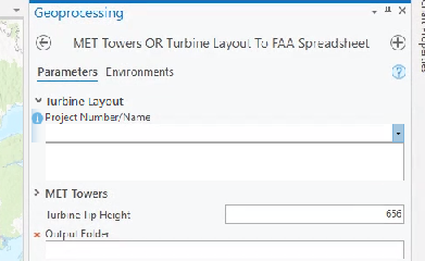

The issue I am seeing is that the values in the list are all empty strings. The number of rows is correct but the values are all empty.
I've simplified my python code to just set ['test1', 'test'2'] as the filter.list and it shows up like the screenshot below. What could I possibly do differently here to make this work? I am going to try the old style toolbox.

Basically, what I think is happening is you're applying the list to a copy of the parameter filter, not the actual filter? (Or maybe not, but that's how it makes sense to me in my head lol) Either way, this works.

Well my script tool is not really that simple which could be partly to blame for the apparent bug. When I copied it into the legacy toolbox is just worked. I did previously try setting the filter.list using the same syntax on a single line previously and it didn't work. My best guess is that something in the script tool itself was causing an issue. Maybe something with the other parameters. Since I've already deleted the .atbx file I cannot copy the script tool from a legacy into a new .atbx to test again. It would take me too much time to rebuild so I am just going to finish it in the legacy toolbox, then if I have time I will take another look. Thanks for the feedback. When I get some time to rebuild in the .atbx I will give it another try.
