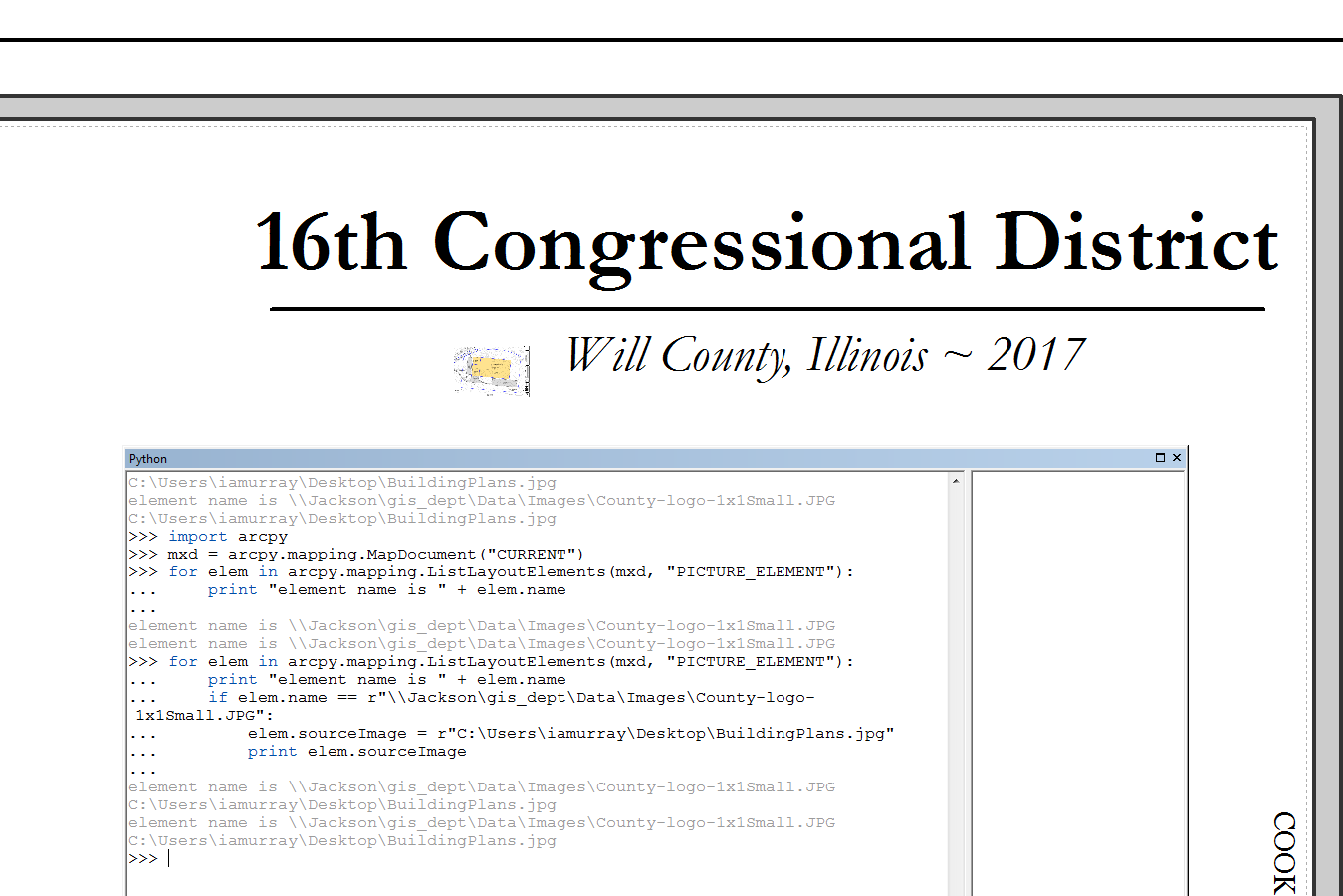

IanMurray
Honored Contributor
Is the path for all the broken pictures the one you noted above?  It would be fairly easy to have a script walk through all the map documents in a directory and replace all the picture elements with that specific path with a new path.
Also I noted something fairly interesting, when a link is working to an picture element, the element name is just the name of the image itself without the file extension, whereas when I opened your map with broken links, the name was now the filepath to where the image was, instead of just the file name.
IanMurray
Honored Contributor
The reason your script wasn't changing anything was because as I noted above the image name was no longer just the file name of the picture, but the full path to the picture.  I used the python window in the map document and managed to change your picture element to a site plan jpg on my desktop.  Your code would have worked fine, but since the elm.name wasn't what you thought it was, it actually didn't change anything.

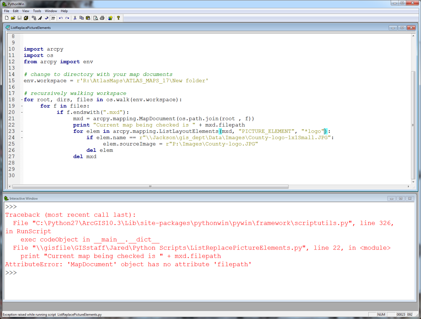

That looks great. But, it's giving me an error. Also, i'm curious why your line 13 is indented? That was giving me an error before i dedented.
IanMurray
Honored Contributor
apologies, it should be filePath, not filepath.  I didn't test it, just cobbled it together from the python interpreter and some old code I had to check for broken data links.

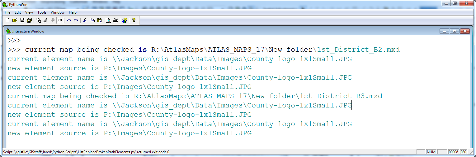

JaredPilbeam1
Deactivated User
Alright, great. At some point during testing I did try the asterisk on both sides of logo.
I added the print statements and the asterisk. It ran with no errors, but no results to the map document again. I double checked and both instances of the JPG in the maps of the workspace are exactly: \\Jackson\gis_dept\Data\Images\County-logo-1x1Small.JPG.
