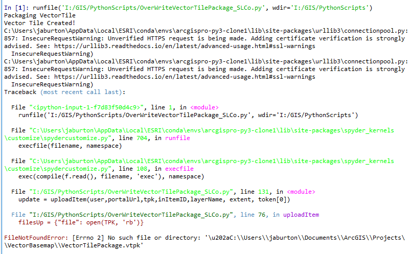

We've been struggling to get a python script running that originally came from ESRI: it's a maintenance script for a vector tile basemaps.  The script hasn't worked for us and the subject line above is the response we got from ESRI tech support.
Below are identical lines of code:  Line one is what we see in IDLE while Line 2 is what we see in Spyder.
tpk =  r'‪C:\Users\jaburton\Documents\ArcGIS\Projects\VectorBasemap\VectorTilePackage.vtpk
tpk =  r'‪C:\Users\jaburton\Documents\ArcGIS\Projects\VectorBasemap\VectorTilePackage.vtpk'
When we run it as a stand-alone script in Spyder it bails out with this error:
So its' not seeing the path where the variable tpk points to. The source of the raw text string is a copy and paste from a Windows Explorer window: pretty standard practice.
How do we convince Spyder all is good?

# -*- coding: utf-8 -*-
at the very top of all scripts

Dan- it already appears at the top of the script; Spyder does it for you...

One of the 2 to 3 things you need to remember... strings are no more... strings are now Unicode and way more character sets are now supported.

Just ran it again with # -*- coding: utf-8 -*- as line 1.  Errors out with the same problem....

even worse... you didn't raw encode or use forward slashes..

It's working now, not sure what the hicup was....

Quick hack to strip out any non-ascii characters:
input = 'C:/temp/test.py'
output = 'C:/temp/test_edited.py'
input = open(input).read()
with open(output, 'w') as outf:
    outf.write(input.encode('ascii', 'ignore').decode())
print(repr(input))
print(repr(open(output).read()))
Output:
"tpk =  r'‪C:\\Users\\jaburton\\Documents\\ArcGIS\\Projects\\VectorBasemap\\VectorTilePackage.vtpk'\n"
"tpk =  r'C:\\Users\\jaburton\\Documents\\ArcGIS\\Projects\\VectorBasemap\\VectorTilePackage.vtpk'\n"
