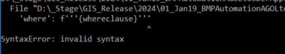

I am creating a data parameter to pass to my Rest Service to Delete a bunch of records.
This works great on my laptop via VPN into my work servers
When a DBA runs this from the server itself I get a syntax error on the WHERE clause... I am very puzzled... wondering if anyone has seen this before...
Again it runs fine from my computer but its not on the server....
        whereclause='1=1'
        gis_payload = {
            'token': portaltoken,
            'f': 'json',
            'where': f'''{whereclause}'''
        print(gis_payload)
        response = requests.request("POST", url=url, data=gis_payload)
When I print the gis_Payload variable it looks good to me...
{'token': 'LRbp-wYEmcO_OFXps89bFEt3HZX34KhpqEAIWJeZE7rgxULrvuAFsSp-cqpkaB74K5ccaDNzjlXuYYCn33cyknr1Vo6', 'f': 'json', 'where': '1=1'}
