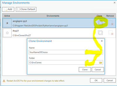

They meaning the ESRI ArcGIS Pro cloning methodology?  The answer is yes.  I treat clones as disposable so if something goes south with one I delete and re-clone.  In the image below, you'll see that I have a directory in C: called 'EnvClones' where I write them to.

Cool, thanks Joe. I haven't touched the environments since 2.4 and I remember it was frustrating to have ...clone_1, ...clone_2, ...clone_3 and not being able to tell what they were for.
