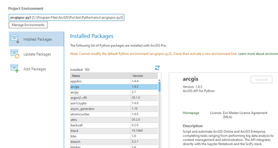

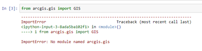

SharonUngerer_DNREC
I have the same error as @ModernElectric but the conda list also brings up an error (SyntaxError).
I am relatively new to using Python is there a step I am missing?
JoshuaBixby
MVP Esteemed Contributor
You provided a screenshot of a Jupyter notebook, is that the Jupyter that gets installed with Pro or do you possibly have other Python distributions on your machine that have Jupyter included too?
SharonUngerer_DNREC
It is the Jupyter notebook that was installed with Pro

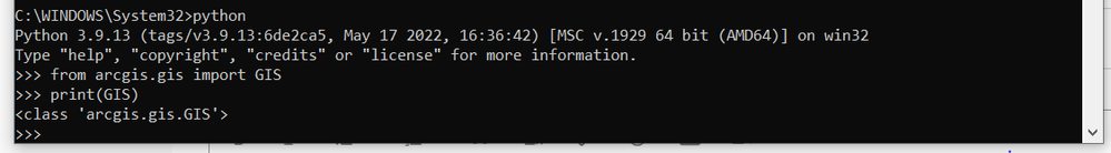

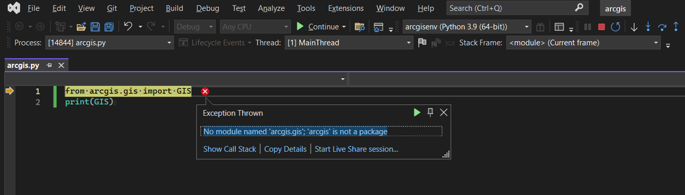

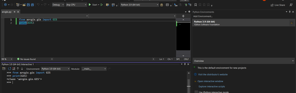

Hello all - I have a similar issue that is hard to make sense to me.
1. I installed Python 3.9.13 and then installed ArcGIS API for python by using pip install arcgis
2. the test codes works fine with python environment
3, but the same codes does not work in visual studio 2022, saying No module named 'arcgis.gis'; 'arcgis' is not a package
4.the same test codes work in python interpreter in visual studio 2022
5. Had used the same way installed many other packages such as Qt, pandas, all works fine in Visual Studio 2022.  But ArcGIS API for Python failed.
Really appreciate any idea.
Thanks,
Shquing
works in python interpreter in visual studio 2022works in python interpreter in visual studio 2022
works in python interpreterworks in python interpreterdoes not work in visual studio 2022does not work in visual studio 2022
swang
it also works fine in Jupyter
