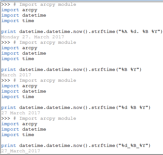

Thanks again,
But I'm looking for the first 3 characters of the month. I wonder if I can get 'Mar17' for March 2017.
print datetime.datetime.now().strftime("%B%y")
gives me March17...
I need Mar17

you can always improvise if there isn't something in advance...
>>> import datetime
>>> d = datetime.datetime.now()
>>> dd = d.strftime("%d %B %Y").split(" ")
>>> dd
['27', 'March', '2017']
>>> "{}_{}_{}".format(dd[0], dd[1][:3], dd[2])
'27_Mar_2017'
TheoFaull
Deactivated User
thank you very much!
I would improvise if I knew how to. I'm still learning the ropes you see...
cheers!
