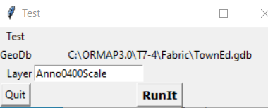

Used  to drive python scripts from tkinter in ArcMap (for years - was stable).  Did a quick test and it still works in Arcpro.  Made the following "VERY SIMPLE Hack" of a tikinter form in python to demonstrate.  Root (form) calls a function "runit" that counts the number of records for a layer in geodb.  This shows a simple way to drive ArcPy stuff from python.  Also nice goes pandas runs well outside of ArcGIS as well.  Here is code.  What it looks like is below (also an attachment as textfile).  Again this was quick and dirty but shows how it works.

Form looks like this:
