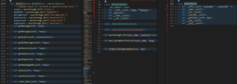

That is very odd behavior...I'm not sure exactly what your environment is, but I'm gonna try and investigate exactly what a Result object is and how it's created to see if there's anything within arcpy itself that could cause this:
The Result object is a subclass of _BaseArcObject and ResultMixin. Those classes define __init__ while Result does not. The only interfaces defined in Result are the attributes (properties) and methods:
In your case, the properties seem to be normally accessible, so is there anything further down the chain that could end up dropping method creation?
The passthrough_attribute function is just a wrapper around property() that builds the properties for the class. Which is odd since those are stored alongside methods...So there could be some malformed result object that failed to create a property while building the class, then failed to build the methods defined after those property function calls.
The ResultMixin defers initialization to _BaseArcObject which builds a new arc_object using the args and kwargs passed by the implementation:

we can ignore the _go method since it does nothing for Result since there is no __passthrough_to_ao__ attribute defined (Row seems to be the only class that uses this).
So when the system creates a result object, it first creates the mixin, then the _base object, then the Result attributes. Your AttributeError names the Result class as well, so we know that we got something that has been defined as Result.
Would you mind sharing the output of a dir() call on the Result?
