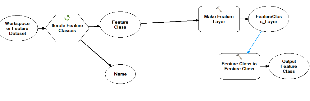

You can do this entirely in model builder...without coding, but if you want to do it with coding the same concepts apply.
Basic Steps:
  1. Iterate feature classes in workspace
    1. Make Feature Class (with definition query)
    2. Export to shapefile
Details:
Model builder has a special tool caled Iterate Feature Classes in workspace. You access it by using Insert > Iterators > Iterate Feature Classes. It accepts a workspace as input. Then you just chain the feature class to Make Feature Layer (with definition query) and then to Feature class to feature class.
You can set definition query in the Make feature layer tool:
You can use %Name% in your parameter to access the name of the input layer:
In python you can do this with:
