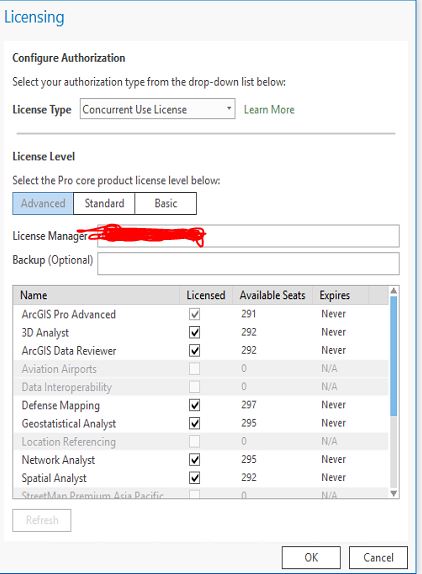

How is is this process accessing a license? 2.7 is licensed through single-use or concurrent use, Pro's licensing is either through Portal, AGOL, or a separate (from "10x") single-use or concurrent-use setup.
ThomasColson
MVP Alum
curtvprice
MVP Alum
I would contact Esri support. I'm not sure concurrent use for Pro supports check-out (maybe through ArcGIS Administrator though?)
ShelbyZelonisRoberson
I use concurrent use Pro with my script no problem. The one difference between mine and yours is I do not have my Pro set to work offline. If you have taken your Pro offline I can certainly see how that could be an issue.
Ever since 2.0.1 this process has worked seamlessly for me. I would definitely suggest contacting Esri tech support if putting your Pro back online doesn't fix the problem.
