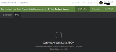

Problem:
When using arcpy to publish a web layer/feature layer collection, I am not getting the item.get_data() object that lists the fields, pop-ups, etc.
Code follows.
Scenario:
* Have a set of maps in a Pro project, each having multiple layers. Pro v3.0.3
* Script loops through these, publishing each of these as web layer (feature layer collection)

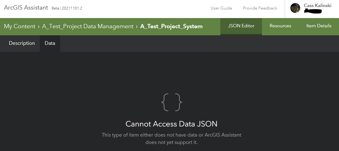

* Publish script runs fine, except that I do not get the data object (i.e. 'text' in item properties I believe) created when I look at it in Assistant.

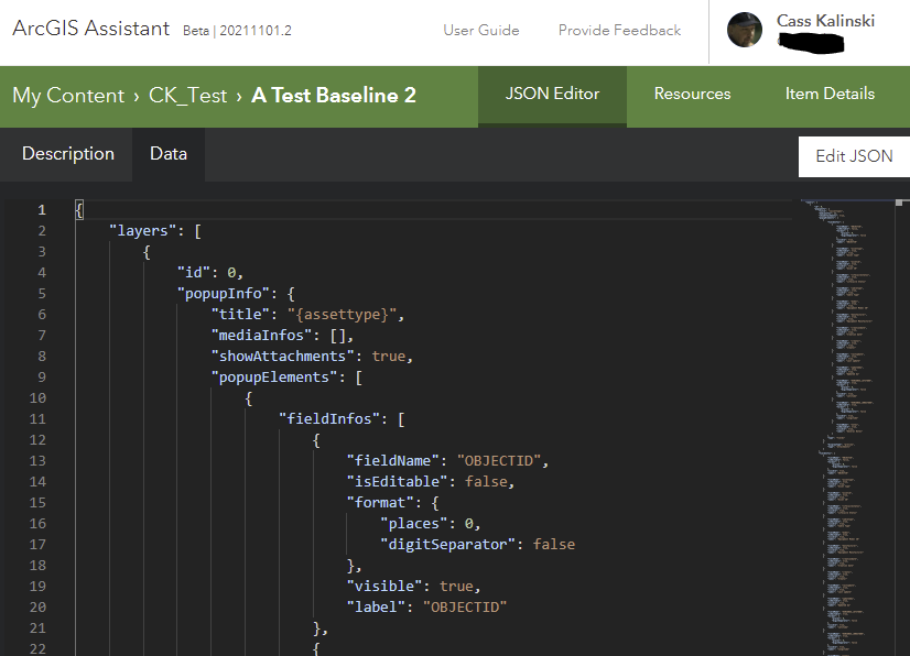

* If I publish the same map manually from Pro, I get the data object. (Share > Publish web layer)
Need this object (specifically, the layers) for the remainder of the scripting that updates popups, field settings, etc. Item object looks as expected except for missing the item.get_data() object. The JSON in the REST end point looks as expected. Feature layer collection functions as expected.
What am I missing? Is there a subsequent step needed to manifest this object in the item?

Hey @CassKalinski , I am running into the exact same issue, even in ArcGIS pro 3.2.1. Its very frustrating when you are trying to standardize publishing with automation.
Our current workaround, is if its a new service, publish from ArcGIS Pro directly (it will create data.json, that was missing from your screenshot). Then any update or changes from aprx, I run the overwrite service and change the data.json myself using the Portal Rest API.
