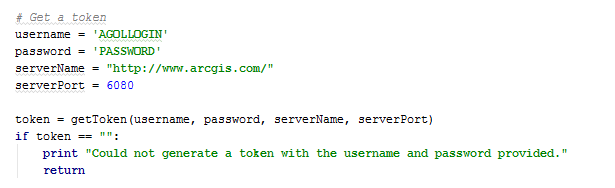

I have tried:
but I am getting an error on the httpConn request saying "getaddrinfo failed".
Any help or direction would be greatly appreciated, otherwise it looks like a call to Esri is in store. Thanks.

The code to generate a token is for an on-premises ArcGIS Server, not AGOL.  This link has a code example for generating a token with in AGOL:
try:
    print('Generating Token')
    tokenURL = 'https://www.arcgis.com/sharing/rest/generateToken'
    params = {'f': 'pjson', 'username': username, 'password': password, 'referer': 'http://www.arcgis.com'}
    req = urllib2.Request(tokenURL, urllib.urlencode(params))
    response = urllib2.urlopen(req)
    data = json.load(response)
    token = data['token']
except:
    token = ''
I'll add that you'll likely want to capture the exception:

And also note that the token is generated using a referer, so any request that uses the token should have the same referer header.
